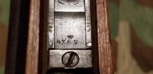

bnz 43 K98 serial number to add
I just acquired a nice, vet bring back bnz 43 (Army) and would like to add it to your bbl serial number study:
4367 s bnz43 bx bnz/1 shield e/623 - All matching
Nice to be back! Here are a few pics:

Care to confirm e/77 x2 on the bolt bottom flat, whether the sleeve and safety is e/77?

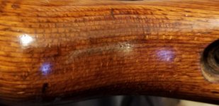

Wrist of stock e/623? Or any other stock markings? Cupped buttplates are almost universally unmarked here, but some sub-contractors are known in 1943. No barrel shoulder number? Getting common by the s-block, looks like a faint 5 or 6 on the side, seen them off-center like this, but hard to say if they are related.. SDP is only consistent in one thing, sloppiness and crudity so probably is, though the meaning escapes a explanation (why 0-9, sometimes an alpha, on the barrel shoulder?)

The safety is 77 marked. The bolt is also double 77 marked with a clear eagle. The ejector assembly, extractor and collar are also 77 marked. Looks like a '0' on the barrel and there is no 623 at the wrist on the lower. The buttplate has no markings nor does the milled follower or milled band spring. From what I've read, wasn't SDP switching to stamped parts around this time?
