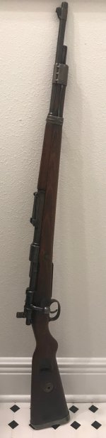

Single rune K98
SN5102 Barrel code ae - Bo Waffenamt wa?23
D9998D47-9A0A-458B-A87E-AF196C190F9C.jpegbnz 43 Single Rune
Posted this over on Gunboards, and MrFarb vetted it over there as a legit example. So posting here as a reference.
https://www.gunboards.com/threads/bnz-43-single-rune-k98k.1179928/
Single Rune SS Contract BNZ 43 that appears to be a “Balkan Capture” rifle, or more precisely, this rifle was acquired by Romania after the war.
Consistent with Romanian use, it wasn’t refurbed, has very little finish left (above the wood line anyway). The bore is still very nice, so perhaps it was carried a lot, but not used much.
Also consistent with the Romanian guns, it’s mostly matching except for the bolt. As noted by MrFarb, the floor plate is a replacement, and the handguard doesn't match either.
This one also has the Astrawerke receiver. The Rune looks good, the serial number and barrel code are correct for these SS contract rifles. As with most SS rifles, has no waffenampts (except on the floor plate). Very light war eagle firing proof on the receiver.

For ALL bnz44 single runes reported, I MUST have photos. To be Frank, I think they are all Ukrainian boosted. I have my reasons, and this study should help clarify these misunderstood Steyr versions.
Admittedly I've not yet read the chapter that covers the single rune rifles, Mr. Farb. But when you say "boosted", should I take that to mean that the runes may have been spuriously applied to those rifles?
Richie
Richie
Yes, either the importer or the selling agent added runes to a lot of RC's at the time - if it was Steyr 43-44 it had a rune added even if it was an Army gun.
