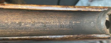

Not a complete rifle, but I have a duffle cut, flat buttplate stock, M.O. WaA 655 s/n 1330 q with stock channel date of 2-21-40. Also a faint ink stamp "5" in the channel. and laminate code "P" below the grip.
Found today a stock complete with metal parts for an early 1937 BSW in letter A. The handguard, numbered with the right writing fonts, is glued laminated! I had never seen glued laminated pieces so early at BSW!
Hi, I to have seen that faint 5 stamp inside stock between the mag-well and the trigger hole ?

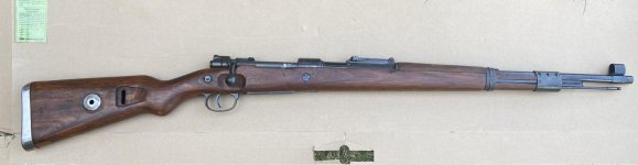

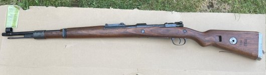

Dear gents can I have some more information about this stock?
looks like white glue laminate, large takedown disc but turned not stamped, from the bolt cut out ‘probably not’ a Mauser Oberndorf. date code on butt indicates 6th day, 42nd week of 194? Can’t make out the last digit. Initials/scratches on butt likely post war.
thanks for the info the numbers on the butt are: 6-42 4
