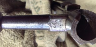

I posted my bolt (on a Prussian receiver/barrel) on the Imperial section. Can you tell me what the numbers on the arm mean?
Gerst, Sam told you exactly what the batch numbers on the bolt meant on your original thread.
I have never seen anyone here take up as much bandwidth with questions that could be answered with a review of the reference section, nor been less willing to listen on answers from knowledgeable folks. Appreciate the interest, but Jesus man, pump your brakes.
Sent from my moto g power using Tapatalk
Hey, chill out. I looked at the reference section. It shows lots of bolts with codes. The section doesn’t tell me what the numbers mean. If you can direct me to the place to look that up, I’d appreciate it.
I posted the bolt here for the lion man.
Post #44. Unfortunately, as we have been trying to explain today, without a serial number not much else can be determined.
