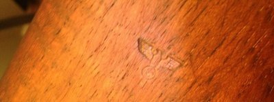

If you had noticed in post number 9, I stated that I have the Steves/Karem Kriegsmodell book, and I stated I fail to see a difference in the stamp on the rifle in question, and the picture posted on page 213 in the book of the correct stamp used on a bnz 44 such as this. Now please explain that.
The Attached Thumbnail you post of a plain eagle stamp on a hardwood stock I fail to see the significance. The book states the laminated stocks used the "Eagle H Stamp" and does not mention another type used for the Kriegsmodell. And again I compared with magnification every line in the picture on page 213 in the book to the stamp on the rifle stock in this discussion and they look identical and I deal with physical fine detail in my work to discern value all day every day and I am very good at what I do IMO and others who rely on me..
