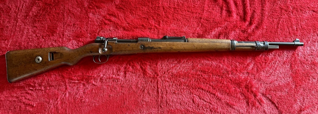

K98k with serial number 10000 ?
Guillaume d'Orange
Gents,
On a French forum, people are arguing that the serialing of K98k ends at 10000 and not at 9999.
They use pics of Gewehr 98.
Has anyone seen or heard about such thing on K98ks ?
What is here strange, normal serialing, the letter range did not end by 9999, when they ordered 100000 pcs so it was delivered 10 ranges per 10000 serial in each range. The possibility found a 10000 is similar to nr.1 also very low, similar is by bayonets and all other weapons normal.
