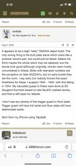

Well folks, thank you all for your replies and insight. Obviously the consensus is that the rifle is restored, and yall know more than i do.
My hypothesis is that the bolt is good. The SN is stamped on the handle root and the shroud. SN acid etched on the safety flag and extractor (the extractor SN is only visible in the right light, only just found it yesterday). No SN on cocking piece (only E/77). No markings on firing pin.
My belief that the bolt is good stems from a reply by Mrfarb in another thread several years ago. A screenshot of the post is attached. He seems to have stated (paraphrased here) that bolts with stamped and acid etched numbers on later build SSZZA4 rifles are the exception to the rule that they would only have acid-etched parts. Forgive me if my logic is flawed, but his statement seems to imply that stamp/acid bolts on late builds DO exist, even if theyre less common than the purely acid etched.
Plus why would someone just have the correctly acid-etched parts lying around for the rifle but not the bolt body or shroud? Id say it’s unlikely even if used as a sporter.
The stamped SN font on the floor plate and bolt appear to match. Harder to tell with the front barrel band, but to my eyes it looks very similar, just possibly a better strike on the front band. I will be removing the white stuff from the markings when i get home tonight and will redo some pics.
Just so everyone understands, I do realize that this rifle may (likely) be a restored piece. I am happy with the rifle regardless. It feels like butter and has a *fantastic* bore, so if truly a restored piece it will make a great shooter. Since general sample size of these SSZZA4 rifles small, i’ll keep putting my “hypotheses” to the rifle into the thread for the sake of discord and personal learning. I truly appreciate all of you interacting and contributing.

Personally I don’t like the bolt, it doesn’t look good. I agree that its possibly been restamped, and the white numbering doesn’t look correct. For the rest of the rifle, like the bands im also suspicious. Unfortunately most rifles on gunbroker have issues, especially SS rifles. But, there are far more people on here that have more experience and are more educated on these rifles. I would say the issues are a fair assessment. Plus, SSZZA4’s aren’t all that common so its a minefield. I would say about almost every SS rifle I have seen on gunbroker always have an issue like; fake runes, fake deatheads, and are just trainwrecks. SSZZA4’s again you don’t see much, so its hard to tell

Bolt is probably bad IMO. All the parts (maybe excluding the cooking piece) have been scrubbed which is unusual for the depot builds. It's common on the ZZA4 repair work, but builds are usually exclusively new/spare parts. Font doesn't look quite right either, and it appears to be the same used on the bad bands.
While the early ones do show up with stamped bolt numbers, those used a very small font on the parts. The more common later guns use a larger font, as seen on the barrel of this one. I don't think I have ever seen a later font gun with a stamped bolt, though I'm sure a few exist sonewhere.
For the price you did ok. A matching sszza4 is now north of 7k - with some 8-9k from recent memory.
As Ryan stated, the “later built” rifles were normally made with new components, but nothing is concrete on depot built anything, SS or not. We only have patterns and a gut feeling. I’ve seen many sszza4 rifles and even some with stamped numbered bolts - but, when you see an obviously bad renumbered part like these bands and stock you really need to question everything else.
