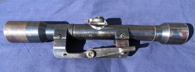

Sauer Rifle Type Scopes
Here are some examples of the types of scopes Sauer used on their LSR rifles. Machine ring DOW was usually in the U letter block. In picture order: Kahles H4X60, Machine Ring DOW, Banded DOW, DKL, and Blued Ajack. I have seen BEK used in Sauer numbered mounts as well.
Nice. Thanks Brian.
As mentioned, a friend of mine owns a LSR mount in the same w letter block with a Zielsechs scope. So while looking at the other pictures here it seems that your rifle is in the correct range to choose between a wide range of possible scopes!
Very good job. Nice to see the base not touching the stock, which was my main concern plus a little odd at the bottom front. A base making such contact will destroy accuracy and damage the stock. It would not leave the factory like that as seen earlier.. Was it just a prior poor reassembly, swollen wood and did you need to use a shim? Looks great.
I had a PU that shoot 1-1.5 MOA for about 2000 rounds. Suddenly it was all over the place. The problem was the action had settled in the compressed stock and made contact with the base. A little shimming and it was back to baseline. It remains one of my favorite shooters.
LSR looks really great well done . That said I would point out one small issue , if You really want to split hairs .It has to do with the finish of the Scope I have never seen a phosphate bek or any other scope with phosphate finish on a Sauer LSR matching Rifle or on a Sauer LSR Mount . As far as I am aware Sauer used only Blued Scopes on their LSR Snipers .But others may have info to the contrary. Best Regards .

Dave i was told before i bought the BEK that it wasnt considered correct. However when it became available at a fair price i couldnt pass on it. I will continue to look for a more correct scope. In the LSR sticky i made sure to mention that this combo was assembled from individual parts so hopefully no one considers my setup correct. I really like the look of the DOWs but im guessin they are pricy when they come up for sale. Thanks again everyone for your help!
