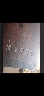

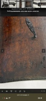

So do you guys believe the stock numbered were German depot applied? The stock was sanded and numbers reapplied to match the receiver and bolt and renumbered front band?
Jory here's a few pictures of my piece to compare yours too. It was a combination of VZ23, and VZ24 parts. The stock was still numbered on the left side by the Czechs but was matched on the underside to the rifle by the Germans. Also duffle cut too. I just wish I could figured out what depot did the work to begin with. Maybe it was just finished at one of the Czech plants 1939-1940 when the Germans were in charge from leftover parts? Who knows but still cool!
Thanks Jordan! And nice rifle. Your font on the numbers on the stock is definitely different than mine…Ostfront for depot? I had a member here suggest that depot as a possibility. He would know way more than me
If the stock is not depot marked, its probably HZa Ulm. They were the depot assigned to handle Czech weapons, and they don't seem to have ever marked the wood for whatever reason.
Yours is similar to my ZaUlm build. Front band SN in the same place, stock SN looks similar, etc.
