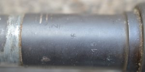

I dug out my other Polish W98. Unfortunately it consists of only a cut receiver and partial Barrel. This example was confiscated by a local PD and deactivated. Of interest to me is this 1923 dated example has the triangle Z stamped on the receiver. This is not present on my matching 1924 dated W98. I am curious if this indicates it was sent back to Radom for work at some point?

comparison of the top of 1923 and 1924 receivers

I’m pretty sure that the Z in a triangle is not FB Radom but actually another arsenal (Zbrojownia) like Krakow or Warszawa.
Z means that it went through refurbishment in Warsaw armory. Ones that were refurbished in Radom have small Radom triangle logo with FB.
They will also might have letter Z in square on barrel or in other locations.
