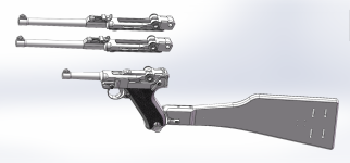

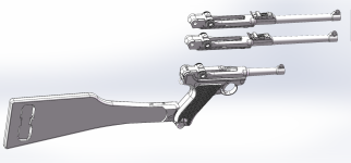

I have "finished" the receiver CAD and am now getting onto the bolt. I am about 80% sure it is accurate, but I have yet to go through validate it. The only parts I have left off the model are the edge breaking operations on the front of the 'rear bridge' besides the stripper clip guide, and the edge breaking operations on the side wall. Those features are monumentally awful to model and I don't particularly want to spare the brain power doing so.
