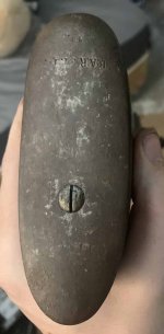

Anyways while I removed the buttplate to scrub more, I broke the gun down again and there are some repetitive proofs and numbers. On the barrel and receiver there are mirrored 1’s, 50’s, Crown over C’s and a pretty large crown proof with no underscribed letter. That crown C proof is everywhere, buttplate, trigger spring, bolt parts, trigger guard and barrel to name a few. The bands do have imperial proofs but no old serials in usual places and no evidence of removal of old serials. Additionally the sling swivel screws are also completely unserialized on both the middle band and the trigger guard.
many thanks as always

OEWG-Steyr
Looks like Steyr played a role here, the sparse comparisons that can be made to acceptance patterns (typically Modell98/88 RR acceptance offer clues in this regard), but RR for this variation and limited available observation for this early Danzig production are not revealing here, the RR acceptance follow no discernible consistency other than 3 acceptance stamps followed by 6, which suggests this is either a original barrel or accountability was not needed replacing a barrel... but on this is pure conjecture (obviously... without CB and out of my specialization we will have to await further well illustrated examples or hope some one here can guess better (not a difficult challenge)
OEWG-Steyr
I had Initially figured that Danzig might have sub-contracted barrel manufacture out in early production as the œwg stamp is present on this danzig made gun yet absent on all the inhouse steyr made 1871's in PrayingMantis's picture reference index. I've seen a couple suhl maker marks stamped on ig 71's that were built by government arsenals so I figured subcontracting happened, but I haven't seen that œwg stamp on other barrels.
Yes, but so few have been discovered and or recorded in detail, - this detail is rarely show on auctions and rare enough on collector posts... I would not discount the possibilities as Steyr was a major player on par with Loewe and WMO and had peers in the rest of Europe, they had many dealings with German arms contracts (and barrels were one of their main products until 1942 - though this looks like a proof not a maker mark so the context is probably different)
The unit on buttplate could be Reserve Feld Artillerie Regiment nr.51, even not R cursive font. Steyr sold a large number of reserve parts to Germany of G1871, but that is not extra documented, only the complete rifles.
