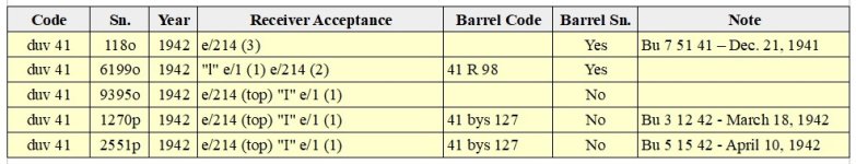

I wonder if the barrel code can provide a clue as to when these were assembled. I see in the KCN datasheet it's 40 Ru 95 and in the OP rifle it's 40 Ru 125. I can't see it in the photos from the auction, but I wonder if Nulle was the winner and whether he still has this?
So looking in the bible it appears that "by the b block of 1942, the barrel serial number had been eliminated". The OP doesn't show that photo, but the 2 examples Loewe shared both have the barrel serial which would lead me to believe these were assembled before 1942.
Looking at reported barrel codes, 40 Ru 4 was used on 4448b and 40 Ru 133 appears on 4175f in 1940, so it would seem that lot #s 95 and 125 could certainly be in the d block of 1940 production. I think that exact barrel code pattern might be important in dating these.

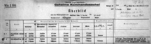

The document shown above states the following: "Discontinuation of all companies that manufacture carbines, with the exception of two companies that are starting up (Sachsengruppe and Steyr)."

The second Waffenamt document is from January 15, 1940 and on the right side under "notes" about the K98k is written:
"Regarding columns 4 and 8:
Lack of workers at Mauser, start-up difficulties at Sachsengruppe (Saxonia Group), assembly difficulties at Steyr. In addition, 2,000 pieces have been manufactured for Kriegsmarine."

Now a quick look at production at Mauser Oberndorf and then Berlin-Lübecker Maschinenfabrik. At Mauser Oberndorf, production ran without interruption and in December 1941 production was ramped up and even Commercial receivers were used to close the gap. You can also see this use relatively well in my diagram with the data from the Waffenamt.
At Berlin-Lübecker Maschinenfabrik the opposite is the case and there have been interruptions in K98k production. Please keep in mind that Mauser Oberndorf was a so-called Leitfirma, they was certainly not the last company to be informed of these changes and to introduce them.
The "bcd 42" Sn.5657a in my table also doesn't have a serial number at the barrel. Like I said before:
"The Waffenamt document TL-1/1003 K98k inspection standard is very useful to date changes etc., in our case to assume the assembly date. The Waffenamt changed to top final on January 28, 1942."
Please look at the Mauser Oberndorf table, "byf 42" Sn. 6013 still has the serial number at the barrel, but it doesn't have a top final acceptance. The next one in my table is "byf 42" Sn. 5540d and it still has barrel serial number and it already has the top final acceptance. Even "byf 42" Sn. 8332e still has the serial number at the barrel. You see, a barrel serial number doesn't mean a rifle was assembled before 1942. Please note the suitable and consistent stock data.
For comparison, please look at Berlin-Lübecker Maschinenfabrik – the "duv 41"wasn't assembled in 1941, they was assembled in 1942 like the K98k's at Gustloff-Werke.
