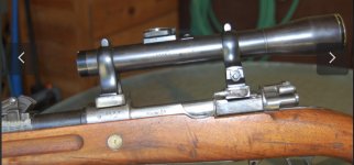

Seems I did the impossible by finding a Mauser Gew98 Sniper rifle which still has the bases installed and was not Turkish overhauled ... but this is also a bit where the head scraches come up - it isn't one of the n-block sniper rifles either!
I got it full in dirt, very certain it was last time cleaned in 1918. And it originally turned up in Australia. All major parts (barrel bands, magazine guard with screw, stock, ...) are matching, follower, safety and bolt shroud aren't (also cleaning rod and muzzle cover are mismatch, but yet have to check all parts in very detail). Very important, the rear base is matching numbers to the rifle on bottom at rear. Bolt is bent and has flattened bolt head on inside, no stock cutout for handle. When I get to clean it I'll post pictures of it in full. Only very roughly cleaned the bases to take these pictures to hopefully be able to get much information soon.
Especially my hopes rely on @Loewe to be able to tell me which year this rifle dates to. I have in my collection a Gerard scope with extremely similar (huge) bases where also the rear base only has a four digit serial. That scope also almost fits my rifles bases, only the rear ring would need to be moved back one milimeter (but I think it is not only clamped but also soldered). Will take pictures of that one too when I get to it.
Attached are the few pictures that I had already taken. They make it obvious that it is a Mauser Oberndorf made Gew98, plus the fitting of the bases also makes it obvious this is an original WWI German sniper rifle.

The receiver acceptance is consistent with WMO in 1914. Here’s Chris’s example for comparison. Being a pre-1917 receiver makes this especially interesting. It could have been assembled later though. The stock will also gives clues as to when it was assembled.

I don’t know if you caught my recent post where I had updated the post war scope with the nice set purchased from another forum member in England.

That thing is wild Georg! It cleaned up nicely.
Beat me to it Cyrus!!! Lol.
I find any original snipers to be very elusive and far above my knowledge set. Very nice rifle! I hope you can find a scope.
Knowing Georg, he's got one laying around. 😎
Not really yes, nor no. As I had mentioned in my starting post, I have a scope which ALMOST fits. And it came with bases to which it fits. And when comparing these bases with the one on the rifle .. well, they perfectly match each other. The scope though has troubles with fitment of the claws at the rear base, would need some fine fitting. Problematic is that the rings are not only clamped, but additionally soldered in position. Anyway, therefore it seems to me this rifle originally would had carried a Gerard B3x scope.
