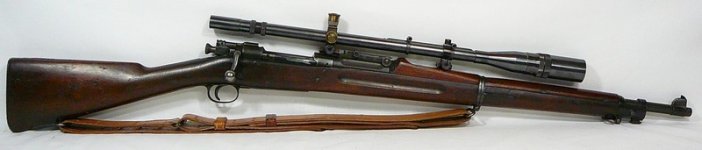

M1903 Unertl USMC Sniper
Absolut
Sorry for bringing up something which is not German, but since we had a discussion ...
The pictured rifle is a verified and original WWII USMC M1903 sniper rifle. It was rebarreled by the USMC either during sniper conversion or in a later overhaul, as shown by the typical barrel vise markings. Since not all were rebarreled, it can't be seen as a typical feature of original sniper rifles.
This rifle is exactly as it was sold off by the USMC - scope bases removed, holes plugged, new handguard added. Note the fine file marks where the scope bases were carefully placed. The USMC also blued the bolt in a beautiful plum coloured blue, while below still the rifles serial is visible - remember that they used ex NM rifles and team rifles for conversion to sniper rifles! Also note the staked trigger guard screws, another USMC feature. Also note the original front sight cover it came with - the enlarged USMC type. And on (nearly) all sniper rifles the rear sight was replaced with the earlier variant, see the dished knob. There are some more very small features that I won't go into detail with, but the ones previously mentioned are already very distinctive and allow to avoid 95% of the fakes out there.
I'm leaving this rifle in exactly the shown condition, there is no reason for it to turn it back into a sniper rifle - it's much more interesting to show how it had been converted back into a service rifle, since I anyway have a second sniper which still has it's scope bases.

By book author and to me the living M1903 legend John Beard - and personally with comparison to other M1903 USMC snipers.
Interesting piece. Had I seen this in the wild, filled holes, wrench marks on the barrel, and staked screws, I would have assumed that it was a bubba special.
That would have been my reaction as well. Actual M41 snipers weren't surplussed and I'd like to see a footnoted reference of one ever having been returned to general issue. Without a national archives hit these are a very gray area. Level 4 and 5 armorers didn't use pipe wrenches and only the most skilled Marine ordnancemen even had access to these. Without the original barrel, authenticating one takes a lot of faith.
The Marines did use a vise when barreling these rifles. This is the reason for the vise marks. Here is a picture of what they used.
First of all, there were very few M41s and these were stored at regimental level or Quantico, scopes mounted, and in individual crates. The vast majority of Marines never got to even see one. A very few of us who had armorer buddies actually got to handle one because these were prized items. They remained on the TO&E lists until at least the mid 60s and our arms control accountability regulations were extremely tight. Any missing weapon had its serial number reported to the FBI and whoever was responsible for it was out several times its replacement cost. How any M41s found their way onto the civilian market during the 50s would have to be a good story. Those I saw at 2/2 in 1963 or 4 were identical in all respects to the original NM Springfields they were made from with the exception of the modifications required to mount the scopes. They were kept in pristine condition.
The stock on the rifle pictured is a replacement with only a drawing number, not the full serial as required. These could be purchased by civilians from Springfield Armory. The original barrel would have been star-gauged at the crown in the six o'clock position with the number on the barrel under the handguard. The barrel date on the rifle pictured is approximately correct to the date of receiver manufacture, so if it isn't original, someone took care to see that it was at least correct. If it has both the large and small gas relief ports, the bolt is the correct nickel steel type but the electric pencil numbering is sloppy compared to mine, which is slightly smaller and more concise. These were numbered at Springfield during manufacture. The bolt shroud appears pitted and refinished and is most likely a replacement. The Marine Corps front sight cover saw service extensively during early WWII at Guadalcanal, Bougainville and Cape Gloucester but during 1943 the Marine Corps finally had the funding and the Garand became its primary battle rifle.
The rifle pictured is interesting, but the tapped non-star gauged barrel, the replaced stock and handguard, the colorized bolt and electric pencil work raise questions that only proper documentation would resolve. Although tapped, its strength is its nickel steel receiver, bolt and barrel. Rebarrels of M-1s, BARs, MGs and M14s were ongoing and I never saw vice or wrench marks on any.
Sir, I don't know where your "story" on Unertl USMC sniper rifles comes from, but it contains lots of errors. Anyone claiming that USMC snipers have blank polished bolts already show that they know nothing on those rifles, and just repeat what is commonly stated wrongly on the internet.
If you research the history, you'll find out that these rifles were built on Team rifles, which itself were rebuilt NM rifles (overhauled), and some were based on original NM rifles. Rebarreling a rifle is just a step during overhaul - and replacing the stock is also a common feature. There are even several pictures of USMC snipers out there, which have the straight grip fingergroove stock on them - they used what was at hand.
PS: many USMC M1903 service rifles were rebarreled - they also have vise markings below the wood. And the interesting thing is when comparing USMC snipers that the vise markings on those who have them, are 100% identical to each other.
Team rifles had star gauged barrels and when they were rebuilt, they were virtually indistinguishable from new. These were also done at Springfield and the wood had cartouches added to any earlier ones present. The original cartouche in your serial range would have been SPG but again, the wood isn't original to the rifle. Parts of your rifle may have once been taken from NM production but there the similarity ends and your time would be far better spent seeking the input of an actual Marine armorer who is familiar with the type of rifle in question when they were still in use, or else simply buy a copy of Brophy's book. The Marine Corps has always been very particular about its weaponry and this especially applies to its match rifles. What I'm seeing is hardly the work of any trained Marine armorer and most likely the effort of someone who tried to create a bogus M41 and gave up. Our workmanship was never that poor with the exception of lower echelon armorers keeping recruits supplied with weapons prior to the adoption of the M-1. These early WWII cobbled jobs with wrench/vise marks are fairly common and typically saw hard use. In summary, withithout actual supporting documentation, what you have is nothing more than a barreled action with four added holes that would be very difficult to sell to any Marine familiar with the '03, 03A1 NM or the M41.
Hello my name is Steve and someone told me to come over here and see if I can help in the discussion some. To let you know a little about myself, for the past about two years all we have been doing is searching at the National Archives for the records of the Unertl sniper program. And building a database of known real rifles, and detailing all the characteristics of them. As of right now we have probably around a 1000 documents on the Marine National Match team rifles, and the Unertl sniper Conversion itself. I really don't think there is too much documentation at this point that we are missing honestly. We have all the NM shipments coming into the Marines from 1919 to 1940, so we pretty much know if your rifle is fake just by the serial number anymore. The details of the sniper rifles are also heavily described in the documents.
I'm not sure where to even start on this discussion as I don't want to knock anyone and it seems several of us here are former Marines, so Semper Fi. In fact I would be interested to talking to Oldcorps to see if he ever saw any of the M1952 snipers with the Kollmorgen scopes, or even of the M1D's in his time. One thing I'm working on now is the history of the Army M1C rifles being used by the Marines, as many of these documents are still classified.
But the Unertl snipers were built on Factory built Springfield National Match 1903's. What happened is the Marines would buy factory SA NM rifles new from SA, they would equip their rifle teams with these new rifles. On average each team shooter had two rifles, one as a primary and one as a backup. At the end of the season the NM rifles were all sent back to Philly and put into one of three categories. New and usused, New and serviceable (usually less than a 1000 rounds), and Used and needing rebarreled. The NM rifles that were rebarreled, had standard barrels put on them, that were star guaged, but not star marked at the muzzle.
The Mairnes bought their own star guage tool (it cost like $300 at the time, I have the purchase order) and did not need to pay the extra fee to SA for star guaged barrels since they had their own tool and could do it themselves. These rebarreled NM rifles were now called Special Target rifles by the Marines. They were in everyway identical to a NM rifle, except now had a replaced standard barrel, and many times were restocked with a new stock. The teams purchased tons of new stocks, as they valued stock fitting more importantly than new barrels. So many of these rifles were restocked multiple times. These special target rifles (rebarreled NM) were then used for Divisional and Elliot trophy matches, and you see Philly sending them out to different Marine bases for that purpose. But only new NM rifles were reserved for the Matches at say Perry. Except the Reserve team did have some rebarreled rifles. But that is another story.
The barrels changed by the Marines at this time do indeed have vise marks. All of them. Including the barrels on the Special targets that became snipers. It was the same tool that changed them, and it's not the one you see all over the interent.
But anyways, there were a 1047 NM and Special Targets that were used for the pool of rifles for the Unertl Sniper conversion, ranging from 1919 to 1940. I have the counts for the divisions in theater in the Pacific, and at Philly and it's a little bit confusing, but my honest best bet is only about half of them were built into Sniper rifles, before the program was cancelled. I really doubt many more were built, as there were not many left in 1951. But a total of 574 of the 1047 possible were rebarreled NM rifles. And at least another 21 fro m the Reserve Rifle team had been rebarreled as well in early 1940. So at least 596 of the 1047 possible NM rifles from the Sniper pool had replacment barrels on them. So it is actually more common to see a replaced barrel on a real sniper than it is to see the actual original Star Marked factory barrel.
I usually don't go much into the details of the real rifles online because of humpers. But a real rifle is pretty hard to fake. There are so many small details that no one knows about, and it clearly states them in the documents on why they are there. And we can even go by serial range and barrel date as we know when they were coming in and when they were buying the replacment standard barrels.
I honestly have no doubt at one time Abolut's rifle was real. I just don't know when it was plugged. But it looks like it was ordered in a shipment of 150 NM rifles in January 1932. It would have been rebarreled most likely for the 1940 Divisional Match competitions as a Special Target rifle. There is a slight chance it might have been done for the 1939 season, but I seriously doubt it. The way the documents read, I'm really betting that barrel was put on there for the 1940 season.
Hope this helps guys, and Semper Fi.
