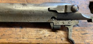

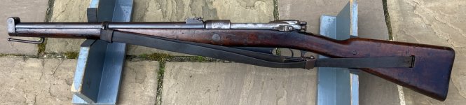

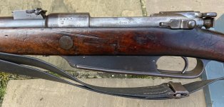

Hi there, not seen many of these come up in the UK. Should i be all over this?
Be interested to know more, so appreciate any info please !

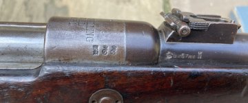

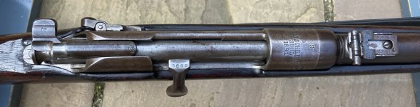

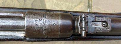

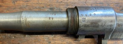

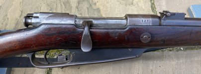

It's actually not a Kar88... it's a Gew91 (note the siderail and the stacking hook). These were a variant of the Kar88 purpose built for foot artillery regiments. Significantly harder to find. This one also looks to have been rebarrelled at some point post 1903/04 by a depot (note the fireproof on the receiver) these did not leave the factory with a receiver proof. They just had to add one if they did work warranting a reproof after the new requirements came into effect (early Gew 98s also didn't have a receiver proof)
There are some British proofs on the rear sight, but I wouldn't let that bug me in the least.

Don't get hung up on the bore diameter misinformation. These were chambered in Patrone 88.
You'll see a heck of a lot more 33/40s than Gew91s. I would instead ask yourself what you are looking to collect. There are a lot of options in this hobby.

Although the price is a little high but I guess what isn't these days lol. It's a nice original piece with a uncommon maker, most I see are Erfurts including mine. The unit marking translates to 11th field artillery if I got that correct lol. It appears they fought heavily in the eastern front and transferred later to the western front towards the end of the war. I probably would pick it up if I were you.
Even though it was chambered in P-88 , it was cleared to fire S ammo . Since no Gew-91's went to Turkey or SA and it has a German barrel on it and it has no Z stamp . It will have [ 99.9 % chance ] the original .311 land / .3208 groove size barrel . I do not know what ammo you have to pick from [ England ? ] A .318 bullet will shoot in it but I would not spend extra or that if you could get some ammo with .321 dia bullets like the older Remington or Winchester 8x57mm , or if you reload use the .321 Win special bullets . Original S ammo also had a . 321 main body bullet . I would not shoot .323 sS ammo in it . What surplus can you get ?

I can't speak for the UK but I've seen matching examples pull north of 2k in the US FWIW.

I see probably 5-10 nice Kar 88s for every Gew 91 in the states. IMO this one being a VCS (rarest maker AFAIK) w/ the Prussian eagle is even more neat.
