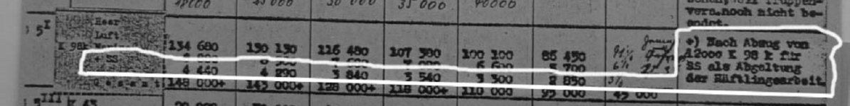

I did some searching in the forum and found this HWA production forecast document:
If it is this document, please do not use it as it would be a big mistake. The K98k marked in the document are not SS rifles! The Steyr SS contract is generally not shown in any of these "Fertigungsvorschau" documents.
These K98k for the SS mentioned in the notes are not regular distributions. These K98k are a payment to the SS for the hours worked by the Concentration Camp inmates in the K98k assembly line - at Gustloff-Werke Werk II Buchenwald.
The SS never received the K98k directly from the K98k manufacturers. Only special agreements with the SS, for work performed by Concentration Camp inmates in the K98k assembly line, were paid in kind, with K98k.

Maybe I will explain the word "Fertigungsvorschau" in more detail, I think there is a need for it. The translation "Production Forecast" is actually correct, but the correct definition of this term is missing. The definition is very important to understand the entire system.
The "Overview of the Army's Armament Status" (Volume Weapons and Equipment) contains the following information on factory production, supplies and total stocks:
1.) Planung (Planning)
- The production program for the next 6 months, drawn up by the Reich Ministry for Armaments and Munitions in agreement with industry. The prerequisite for this planning is the timely and sufficient allocation of the raw materials, labor, machine tools and energy necessary to fulfill it.
2.) Fertigungs-Vorschau Wa A (Production Forecast Wa A)
- The production forecast by the Heereswaffenamt (Army Ordnance Office) for the next 6 months based on the already existing or assured allocation of raw materials, labor, machine tools and energy.
3.) Abnahme Wa A (Acceptance Wa A)
- The weapons and equipment manufactured and prepared for dispatch after acceptance by the acceptance departments of the Heereswaffenamt (Army Ordnance Office).
4.) Zugang Fz.In. (Incoming Fz.In.)
- Incoming weapons and equipment in the Zeugämter (depots) of the "Fz.In." from new production or repair, conversion and loot.
5.) Abgang Fz.In. (Outgoing Fz.In.)
- The supplies from the stocks of the Fz.In. were used for supplies, refreshment, new formation, reserve army, testing and acceptance purposes of the Heereswaffenamt (Army Ordnance Office) and for agencies outside the Army.
6.) Bestand Fz.In. (Stock Fz.In.)
- The supply stock available on the 1st of the reporting month.
7.) Verbrauch (Consumption)
- Reduction of the total stock due to losses in the troops and transfers from the Field Army to agencies outside the Army.
8.) Gesamtbestand (Total stock)
- The inventory available to the troops and Fz.In. on the 1st of the reporting month.
As you can read in the description above, the Fertigungs-Vorschau is not the actual production and we collectors do not need it to estimate the actual production, the relevant figures can usually be found on the other docs. But the Fertigungs-Vorschau is very useful for other things for us collectors. If the Fertigungs-Vorschau differs from the actual production, there are always certain reasons for this. There may be certain events that have hindered production, for example unexpected transport difficulties in winter. The armaments could have been redirected by a Führer order, for example. Production and, above all, the start of production of other weapons (like G.41 and G.43) could have resulted in capacities being lost. The bombing raids on Steyr in February 1944 and also on Gustloff-Werke Werk II Buchenwald in August 1944 can be seen. The year 1944 is generally very complicated because several of the reasons mentioned apply.
To make it easier to understand, here is the Fertigungs-Vorschau document and the relevant part with K98ks is shown enlarged.fertigungsvorshau.jpgfertigungsvorshau - Kopie.jpg
As I already mentioned, these white marked rifles are not SS K98ks, this assumption is a mistake and the Steyr SS contract is generally not shown in these Fertigungsvorschau docs.
The 22,260 white marked K98k are the 3% share of the Kriegsmarine from May 1944 to October 1944. Not SS, these are Kriegsmarine K98ks
Please look at the month of May 1944 and to the left of it is listed the following:
Heer
Luft
Marine
+ SS
Gesamt (Total)
As can be seen from this document, 148,000 K98k were expected to be available for distribution to the Heer, Luftwaffe and Kriegsmarine in May 1944.
Heer should get 134,680 K98ks (91%)
Luftwaffe 8,880 K98ks (6%)
Kriegsmarine 4,440 K98ks (3%)
The 148,000 K98k is just the expected total amount that should be divided between Heer, Luftwaffe and Marine and that is why it is called "148.000+".
In the Bemerkungen (notes) is written: "+) Nach Abzug von 12.000 K98k für SS als Abgeltung der Häftlingsarbeit" the translation is: "+) After deduction of 12,000 K98k for SS as compensation for prisoner labor".
The expected total amount in May 1944 was 160,000 K98ks, the SS should get 12,000 and the remaining 148,000 K98ks was for the other branches. The SS should get 12,000 K98k in May, June, July and August, later the numbers got changed.
The explanation of how this worked can be found in the Volume II book, in the SS Chapter on page 732/733 (Please look at No.2 in the document) Here is the excerpt from the book:
