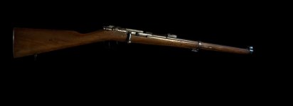

I picked this up earlier in the week. Rear portion of bolt (Safety, striker and cocking piece) are mismatch but other parts are matching. Receiver has an 1877 mfg. date but no issue date or unit markings are present. Tang screw is tight and I am unable to get it out of the wood to check the barrel markings. The carbine is probably my favorite variant of the 71, as they are short and handy.

That's a nice looking CGH, or as I've heard it called by someone once, CJ Heinkel 🤣
I agree on these being a nice handy little carbine. It's a nice clean one overall!
Great Kar 71 carbine, Marc! I love these little guys, too; certainly are handy and the nose looks cool. I’ll get her in the reference!

Nice piece of wood on that one Marc….. Nice carbine
That's a great little CGH Kar 71, love the wood on this one! Congrats!

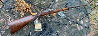

Hey guys…sorry it was late last night and I wanted to take the photos outside for you.
I’ve never seen another one…there is a serial number on the buttplate and proofs on the bolt handle.

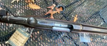

The inletting of the stock is first rate as well as the checkering..there is still some color case hardening showing in the receiver ..the rear sights are express style with ivory ( I think) sighting aid for low level light..the front sight has a pop up bead feature….set triggers and horn furniture…37FE3435-EA39-47EF-B603-59362E906650.jpegB5BEEB17-F1D3-497A-9228-92C277B9ABF7.jpeg76667198-A9F7-4CAC-A703-07D0541DCF37.jpeg0E4ACDF1-AD61-49D1-867D-AF3699BDCAA9.jpegF4646D89-7625-48AB-A311-4DB0917E879A.jpegE7F5786B-7F8C-4579-9956-4FA3BA7D71A5.jpegF24CA2A2-208F-44EE-9B14-F0E25DBC40B4.jpegCEC46D6F-BE62-4122-A10C-8D86E19E2958.jpegD9456FBC-6867-44C9-BC11-FBED560E88BC.jpegBCE36C84-35BB-4867-8C60-20441CA5E001.jpeg338AFD5B-F783-44AD-A26A-3FD2EB8B6F91.jpeg20DDB43A-7B74-4656-A2CB-AA8B2F2A1758.jpeg1EDF4D8B-F85E-4046-AF15-3FD55A1A62A2.jpeg71634152-75F6-4304-99EF-C71FCB41289B.jpeg42209151-7920-49F8-8A7E-5EB4DB49D184.jpeg
The inletting of the stock is first rate as well as the checkering..there is still some color case hardening showing in the receiver ..the rear sights are express style with ivory ( I think) sighting aid for low level light..the front sight has a pop up bead feature….set triggers and horn furniture…View attachment 419723View attachment 419724View attachment 419725View attachment 419726View attachment 419727View attachment 419728View attachment 419729View attachment 419730View attachment 419731View attachment 419732View attachment 419733View attachment 419734View attachment 419735View attachment 419736View attachment 419737

Thank you so much for taking the time to photograph. Typical exceptional workmanship on a commercial Haenel. A few things that are of interest about this rifle. The action is not quite an 1871, but looks to be a simplified/altered 1871, which is surprising and interesting. They occasionally made "oddball" versions that were modified, and this one might be an example. Also of interest is the R U proof, which shows it went back to the proof house at some point. The 88' that I referenced earlier is serial 2796, and has the "rare" V proof which means it was already built, but on the shelf at the implementation of the 1893 proof laws. This would indicate that your rifle was produced at some point before 1893, however went back in for some reason for some work which necessitated a visit to the proof house.
Are you willing and able to take the rifle down for more pictures in another thread? I would be very interested to see if there are any barrel markings and if you would take down the bolt and action to examine it in detail. Just to confirm the serial number is 2039?

I’ll try to get it tonight. The action is a little different…it’s a little shorter than a 71’…you have to insert the bullet into the chamber rather than simply laying the whole cartridge on the feed tray..I’ll show that in some photos.

I can’t get it out of the stock…I don’t have the blade for the tang screw (and I have a ton of screw driver blades) - that fits…I don’t want to bugger up that screw head.
I did get some shots of barrel markings for you and a C/V on the left side of the receiver, opposite the chamber. The barrel markings are on the ride side of the barrel, just forward the chamber.A89B1ADE-6A0C-4B56-B68B-243DC57445D8.jpegD5DE4BAC-D808-4C71-B3C9-A4829245848D.jpeg1EFEDB75-DCFA-478A-A7E5-65AA8600DA5B.jpeg
As for the bolt…it’s a smaller version of the 71. I took some shots of the action with a round in it next to another 71 surplus sporter that I have…you can see the difference in the loading tray…
Here are some shots of the bolts together for comparison and some shots of the other proofs on the bolt-
I’ve taken a 71/84 bolt down but not a 71…I err on the side of caution with these older pieces…
