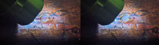

More pictures, and apologies as I am trying to capture with my phone what I am seeing under the magnifier glass.
After a cotton bud and mild degreaser I have managed to uncover more letters , which should hopefully decode the area. The middle ding could be brought up with steaming, but may leave as is...

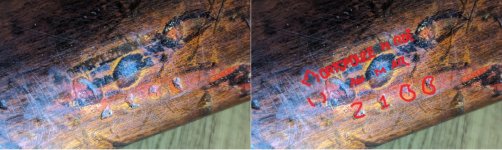

Photos of what I believe I can see I can see with my doodling with ms paint. Of course this is purely subjective (feel free to correct me).... Also please excuse the unsteady hand!

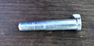

Not sure about this cleaning rod though ?

I wouldn't advise any invasive cleaning, steaming or other methods. Enjoy it as it is, you don't want to risk irretrievably damaging it.
The cleaning rod is not correct, but you can find VERY high quality repros for a reasonable price.
The buttstock was mostly black painted or dyed? and someone fixed it by claws so visible many traces of press areas there in claws. I believe You could already confirm what MichaelWC already mentioned upper row is OrtsPolizeiBehoerde , 2166 is probably the inventory number, the middle part should be looked for lists of areas that came in question. I personally would use nothing abrasives but there are more time lyers of not period laquer. By middle part i would say Windhoek?? as possible. Application of beewax on cleaned buttstock could stabilise it, the black paint probably helped better to see the stamping in that case.

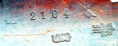

So here's three examples of police 1871 Jägerbüchse used by Town Police in German South West Africa. I figured these would be good references.
1880/Danzig/2343/This rifle is marked "ORTSPolizeibehörde Bethanien 359" (This would indicate that it was used by a Kaiserliches Gouvernement Polizei unit at Bethanien in SouthWest Africa, prior to the formation of the Landespolizei in 1905. 359 would be the weapon issue number.)
1881/Danzig/9564/? (This rifle is marked with the Imperial Eagle colonial proof mark next to an "S." The "S" next to the Imperial Eagle colonial proof could stand for Spitzkoppe. With an issue number of 2104.

Having a closer look , I can see the numbers 12 under the ORTS part. I think AndyB may have nailed the location with Windhoek, as I shine the light on it , what I thought was an A looks like a partial W and and I, and that looks like a k at the end/ Could this be Windhoek ?
As for the paint / dye. I think its just patina, there are elements of red tints here and there , which I think may be filler touch ups.
Hi all, Thanks to you, now I can now put this locality mystery to bed, and best of all with no intrusion. Simply wet my little finger (no nails!) and a single forward and backward rub, and this reveled the remaining lettering.
As you can see the dink has slanted the letters inward, which makes sense with it being pushed down. Again hard to show you what I see up close with my phone pictures, but I can 100% confirm with my own eyes that the lettering spells Windhoek.
